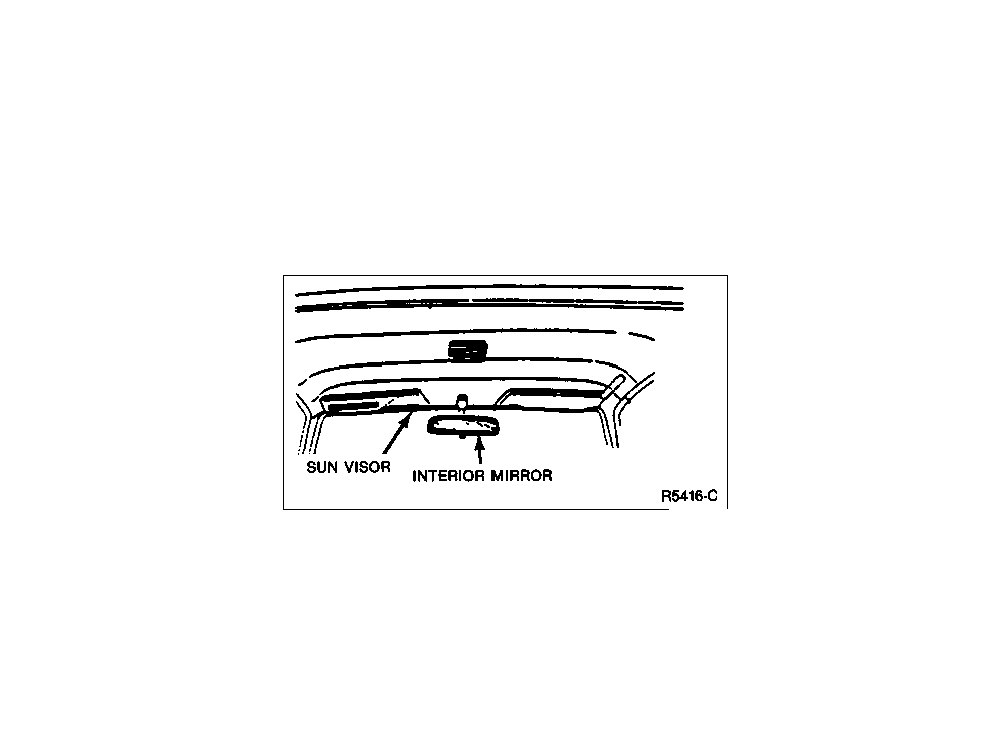

2. Remove the interior rearview mirror. Refer to «Section 01-09».
3. Remove the sun visors.

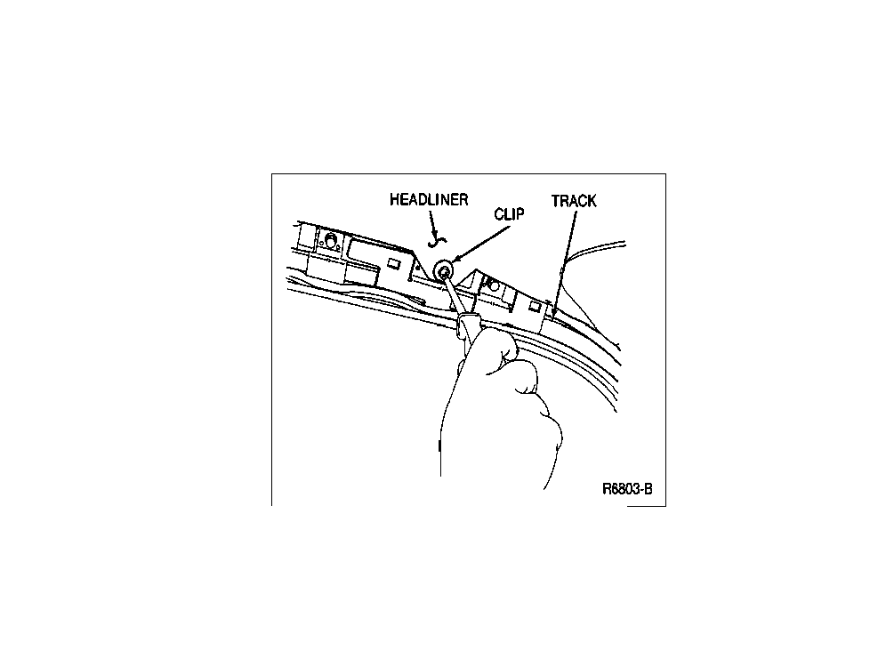

7. Remove the headliner clips.
8. Remove the headliner.
